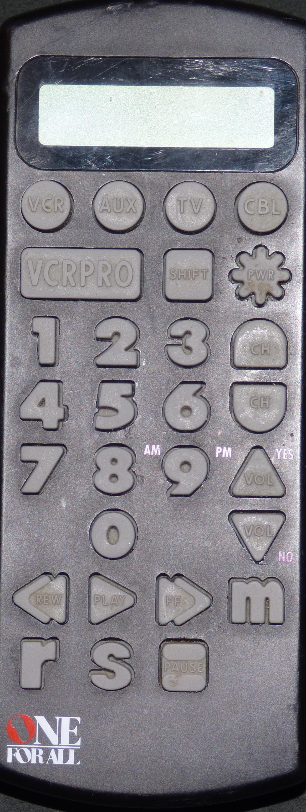

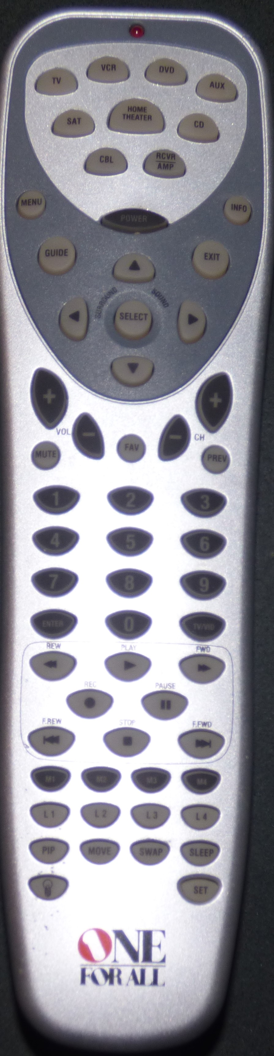

Here are my other URC remotes:
URC-6885
URC-8811B00
